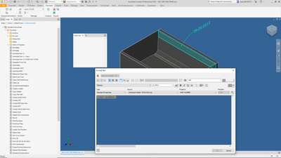

theo.bot
@cparnellCDZ7D
It looks like you created a leader note, not a general note.
If you want to get the leader note info you could use something like this:
Dim oDoc As Document
oDoc = ThisDoc.Document
Logger.Info(oDoc.ComponentDefinition.ModelAnnotations.ModelLeaderNotes.Item(1).Definition.Text.FormattedText)
