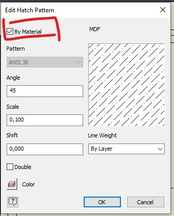

is it possible to create an iLogic that would activate the "By Material" option for all Hatch Patterns, for all sheets?

Yes you can. But you can only set this option when the material is defined in the Standard Style. When you change the material of a component to a material that is not listed, then automaticly this value is set to false and is't not available for selection.
here is a small sample:
Dim oDoc As DrawingDocument
oDoc = ThisDoc.Document
Dim oSheet As Sheet
Dim oView As DrawingView
Dim oHatchRegion As DrawingViewHatchRegion
For Each Sheet In oDoc.Sheets
	For Each oView In oDoc.ActiveSheet.DrawingViews
		If Not oView.HatchRegions Is Nothing Then
			For Each oHatchRegion In oView.HatchRegions
				'Set ByMaterial
				Try
				oHatchRegion.ByMaterial = True
				Logger.Info(oView.Name & ": HatechRegion.ByMaterial = " & oHatchRegion.ByMaterial)
				Catch
				MessageBox.Show("The Material of the sectioned component is not in Style definition, please add the material before ByMaterial can turned on", "Set By material")
				End Try
			Next
		End If
	Next
Next
