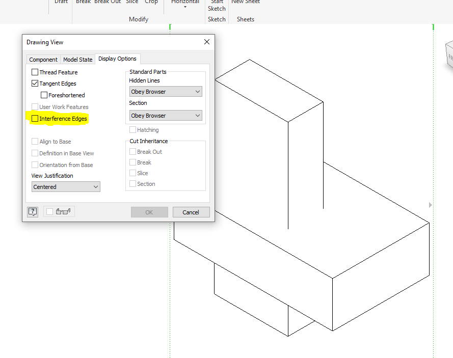

Hi all,
I have an assembly with a bracket fixed into a concrete slab (see below)
The problem is I would like to see the intersection edge in my drawing. See below again:
Is there any setting in Inventor that I should check?

Hello Hashang,
is this in a drawing?
in 2017, edit the view, and select, display options tab, Interference edgesCapture.PNG

This situation occurs whenever a part is sticking through another without a visible mating face.
Simply double-click on the view and select "Interference Edges" in the "Display Options" tab.
Thanks for the reply. That was it. But I was wondering if I can have this feature enabled by default for all of my views in drawings (something like Application Setting)
