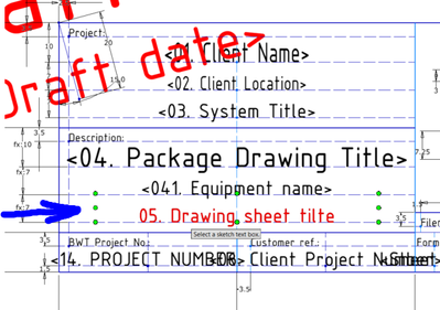

Hello all ,
Hope you are well

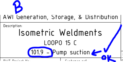

I’m looking to populate the Prompted Entry with the title of the assemble of the first view on the sheet with iLogic.
We have multiple sheets and multiple assemblies and we want the 1st view on the sheet with that name.
But still allow it to be a prompted Entry to be edited if necessary.
I have been able to pull the drawing view name and place it into the tree sheet title ( see below Red underline) but cant make the leap to the prompted entry.
The underlined   125 – Post UV stage QE5.1 sample,  would be an example of the name that comes from the 1st drawing view on that sheet.
any help would be great.

The most likely place in that code for it to fail would be where it is checking the contents of the TextBox.FormattedText, because that part can be pretty complicated to predict.  Here is a technique you can use to find out what exactly that text box's formatted text really contains, so we know more specifically what to search for.  You would need to manually enter the edit mode of your title block so that you can select that specific text block first.  Then run this iLogic rule to get/show the contents of its formatted text.  When you use a MsgBox or MessageBox.Show, the text won't be selectable, but when you use an InputBox, then put the text in the 'DefaultResponse' position, it will be selectable (and copy/paste 'able).  You can use similar code to check the contents of things like leader notes on your drawing, when changed appropriately.
oObj = ThisApplication.CommandManager.Pick(SelectionFilterEnum.kSketchTextBoxFilter, "Select a sketch text box.")
If oObj Is Nothing Then Exit Sub
If TypeOf oObj Is Inventor.TextBox Then
	Dim oTBox As Inventor.TextBox = oObj
	oFText = oTBox.FormattedText
	MsgBox(oFText, , "FormattedText Contents")
	'this will be 'selectable' because it will be in the input field
	a = InputBox("","FormattedText Contents", oFText)
End If
Once you can select the contents of that text box's formatted text, then we can update that line of code that is checking its contents accordingly.

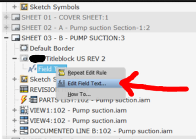

G.Binl
@WCrihfield
tested the last code you sent and nothing happened after selecting the textbox and it go me to thinking that maybe I miss led the question at hand.
for each sheet I have to go into this portion of the tree and edit both red arrows.
The Red arrows is the only thing that can be changed  at this window everything in blue comes from iProperties Custom
want to make sure were talking apples to apples because this it over my head at this point but learning.
Message 11 of 16

G.Binl
@WCrihfield .
This is great, ok we are getting closer Wait you are getting closer this works as long as the prompts contain
the set values.
If oVal ="xxxxxxxxxxxxxxxxxxxxxxxxxx"
Elseif oVal = "NTS"
see diagram A.
I Tried to figure out a way to do this if the prompt is empty or has text already in it.
Itried this code.
If String.IsNullOrEmpty(oVal) Then oVal = "xxxxxxxxxxxxxxxxxxxxxxxxxx" Else Continue For
		If oVal <> "xxxxxxxxxxxxxxxxxxxxxxxxxx" Then oVal = "xxxxxxxxxxxxxxxxxxxxxxxxxx"
		If oVal = "xxxxxxxxxxxxxxxxxxxxxxxxxx"
and it seemed to work I know your eyes are hurting.

So my another question is can I use simple code like Right, Len & left on the variable  oVal?
I would like to remove the leading number in this case the 101.9 -,   See diagram B
I have some code that I have done this with but haven't figured out how to do it with the current code.
A set value works fine there maybe a few sheets that I will manually change better then 75 sheets of change.
BTW this has been a very eye opening experience for me with great appreciation.
