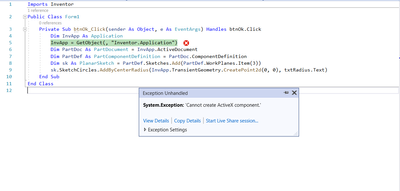

I am trying to run the following code using Visual Studio 19, and Inventor pro 2022, Windows 10 and it wont run. I am new to VB but I have lots of experience with VBA. I have followed the instruction line by  line form this link https://www.autodesk.com/autodesk-university/class/Creating-Add-Ins-Inventor-2018#video
and I can't get it to work, I also tried the method below and still same error
System.Runtime.InteropServices.Marshal.GetActiveObject("Inventor.Application")
can someone help please?

Anyway, GetObject normally get's a running instance of Inventor. If it is not guaranteed that Inventor is running, then you should try to create one using this:
Private Sub btnOK_Click(sender As Object, e As EventArgs) Handles btnOk.Click
        Dim invApp As Inventor.Application = Nothing
        Try
            Try
                invApp = System.Runtime.InteropServices.Marshal.GetActiveObject("Inventor.Application")
            Catch ex As Exception
            End Try
            If invApp Is Nothing Then
                Dim inventorAppType As Type = System.Type.GetTypeFromProgID("Inventor.Application")
                invApp = System.Activator.CreateInstance(inventorAppType)
            End If
            System.Windows.Forms.MessageBox.Show("There was a problem starting Inventor.", "Error", MessageBoxButtons.OK, System.Windows.Forms.MessageBoxIcon.Error)
        End Try
    End Sub

I tried the code you suggested and it gave the error message as you set , so obviously there is an issue with getting Inventor application

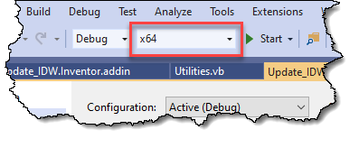

Yes, inventor is installed and as per instruction in the training , its open with a new part. I tried running it as an administrator and still no luck.  I have attached the project here. Also, I tried to change this from Any CPU to X64 as per the instructor advice and still no luck.

I just tried this code with Inventor 2020 and it works fine! so the problem is IV2022 , any idea why it doesn't work with the 2022 version?
