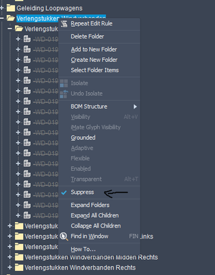

Hi All,
I need to manage the suppression states of alot of parts and folders in an assembly.
Now i use addapted code from manufacturing DevBlog
https://adndevblog.typepad.com/manufacturing/2015/05/suppress-folder-in-assembly.html
This works but with 60000+ parts and multiple folders it takes a long time to itterate through all.
The rule above suppresses every seperate occurence in a folder (+100occs) even tho i could suppress the entire folder
the following snippet is much faster in suppressing entire folders:
oDoc.SelectSet.Select(oBFolder)
		ThisApplication.CommandManager.ControlDefinitions.Item("AssemblyCompSuppressionCtxCmd").Execute
The problem with this is that I am not able to get the suppression state of the folder before toggeling it.
So if i need it suppressed and it is allready suppressed i can not check the status befor toggeling it.
Is it possible to get the folder suppression state in some way as it is shown in the Rightclick menu.
(the isActive part for BOM is not an issue in this situation)
Any leads would be greatly appreciated.

A very similar topic was started on this exact problem a day or two ago. doesn't look like its possible past cycling through each object in the folder and checking if they are all suppressed.
Sub Main
	Dim oAsm As AssemblyDocument = ThisDoc.Document
	Dim BrowserPane As BrowserPane = oAsm.BrowserPanes.Item("Model")
	For Each oFolder As BrowserFolder In BrowserPane.TopNode.BrowserFolders
		Dim bSuppressed As Boolean = True
		For Each oPart In oFolder.BrowserNode.BrowserNodes
			If oPart.NativeObject.Suppressed = False
				bSuppressed = False
                Exit For
			End If
		Next
		MsgBox(oFolder.BrowserNode.BrowserNodeDefinition.Label & " Are all Suppressed? " & vbLf & vbLf & bSuppressed)
	Next
End Sub
