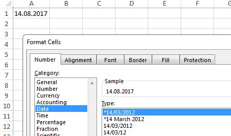

martinhoos
Hi Craig,
thx for your reply. Pls look at the pic.
Regards Martin
Message 8 of 12
I don't have the same options as you do in my excel cel format (see attachment). But this is the code I tried and I attached a picture of the resulting msg box
myCell = GoExcel.CellValue(myXLS, "Sheet1", "A1")
MessageBox.Show(myCell, "Title")
What version of excel are you using? Perhaps try this line instead:
Dim myCell As Date = GoExcel.CellValue(myXLS, "Sheet1", "A1")

Message 10 of 12
martinhoos
Hi Craig,
the result of the first solution:  42961
If i try
i get an error:
I use Excel 2010
Thx for your help!
Regards Martin
