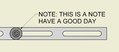

I've had a script for adding leader text to the center of a selected line in drawings for a while. I just fixed a bug where selecting a circle would cause the code to fail. I figured out that the MidPoint of a curve doesn't exist for circles, so if that is nothing, I'm using the CenterPoint instead.
Now for my actual question. I would like to have my leader attach to the outside of a selected circle instead of the center point. This is just because I'm curious and think it would look better that way. So if anyone can help out I'd appreciate it.
Example of where I would like to have the leader attached.

use Circle2d:
Dim ocircle As Circle2d = oDrawingCurve.Segments(1).Geometry
then you can play with it like:
   Dim oGeometryIntent As GeometryIntent = oActiveSheet.CreateGeometryIntent(oDrawingCurve, oTG.CreatePoint2d(oMidPoint.X +ocircle.Radius, oMidPoint.Y ))
 or
   Dim oGeometryIntent As GeometryIntent = oActiveSheet.CreateGeometryIntent(oDrawingCurve, oTG.CreatePoint2d(oMidPoint.X , oMidPoint.Y +ocircle.Radius ))
or
        Dim oGeometryIntent As GeometryIntent = oActiveSheet.CreateGeometryIntent(oDrawingCurve, oTG.CreatePoint2d(oMidPoint.X + sin(ocircle.Radius), oMidPoint.Y + sin(ocircle.Radius)))

Thanks, that was a bit easier than I thought it might be.
