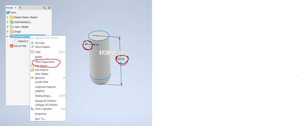

I have a problem to solve
I made in part
First, I show DIMENSION
Then I pick a value of DIMENSION in Sketch
And save it auto as "L1" in the CUSOM of IPROPERTIES

thanks for the answer. But for some reason I need to do it in a way of picking each value on Sketch.
you can create a code to do that?

Hi @haphanthanhtam.work.  Yes, it is possible to pick a DimensionConstraint within a Sketch, then get the Parameter it represents, then try to expose that Parameter as a custom iProperty.  Here is a simple example iLogic code like that:
oObj = ThisApplication.CommandManager.Pick(SelectionFilterEnum.kSketchDimConstraintFilter, "Select a Sketch Dimensional Constraint.")
If oObj Is Nothing OrElse (TypeOf oObj Is DimensionConstraint = False) Then Exit Sub
Dim oDimConst As DimensionConstraint = oObj
Dim oParam As Inventor.Parameter = oDimConst.Parameter
Try
	oParam.ExposedAsProperty = True
Catch
	MsgBox("Error trying to expose the parameter as a custom iProperty!", vbCritical, "Failure")
End Try
If this solved your problem, or answered your question, please click ACCEPT SOLUTION .

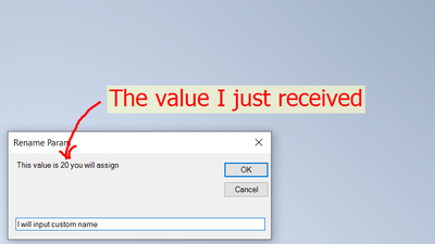

haphanthanhtam.work
Hi @WCrihfield
Thanks for the help
Can i ask you 1 question. It will solve a string of my problems
I have a code used to get the minimum bounding box dimensions
Instead of showing 3 sizes I want it to show notifications
Ex:  20 x 37,895 x 50
I want it to announce that:  This value is 20 you will assign "Custom name"(I will input custom name value)
I want it to announce that:  This value is 37,895 you will assign "Custom name"(I will input custom name value)
I want it to announce that:  This value is 50 you will assign "Custom name"(I will input custom name value)
I think you can help me, you can help me

haphanthanhtam.work
i want this rule to create 3 custom iProperties (one for each directional size), and write these values to those iProperties. I know it won't change when the model changes

OK.  I added this section of code to your rule, just after the 3 values have been converted and sorted, but just before it starts the 'transaction', so that they will not be removed when the transaction is aborted.
'write values to custom iProperties with prompts for names
Dim sName1, sName2, sName3 As String
sName1 = InputBox("This value is " & minLength, "Assign Property Name", "")
If sName1 <> "" Then iProperties.Value("Custom", sName1) = minLength
sName2 = InputBox("This value is " & midLength, "Assign Property Name", "")
If sName2 <> "" Then iProperties.Value("Custom", sName2) = midLength
sName3 = InputBox("This value is " & maxLength, "Assign Property Name", "")
If sName3 <> "" Then iProperties.Value("Custom", sName3) = maxLength
...below is the whole thing, after that has been added in.  I hope this works the way you want it to.
