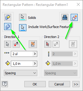

im not exactly sure what you are trying to do but if you want to get multiple bodies from a pattern then you should make the pattern like this.
JelteDeJong_0-1631866652491.pngthen you will get multiple bodies.

Thanks @JelteDeJong
But is it possible to get bodies separately without this change somehow through API's? Like for attached part without modifying pattern feature?
Thanks again!
