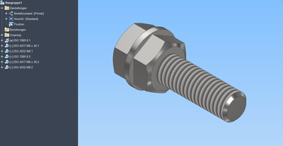

ca-d.one
Hi Jerry, hi fredform,
Your question got me curious, so I tried it out myself. Here's what I did and what came out of it.
Short answer first
You don't need anything special in the API. System.GC.Collect() isn't an Inventor command, it's plain .NET. So it works the same in iLogic, in an add-in or in a standalone app (VB.NET or C#).
Most people use the "double" version, because it also gives pending finalizers a chance to run:
(In VBA there's no garbage collector at all. There you can only let go of your own references with Set obj = Nothing.)
What I tested
I wanted to see whether you can place Content Center parts through the API directly, instead of using AddContentCenterPart. This way you have more control, and you can clean up after each part. Here's how I went about it:
Looked at the Content Center tree. First I ran a small read-only rule that walks through the tree and lists the families and their columns. That's how I found where washer, bolt and nut live in my (German) library, e.g. Verbindungselemente > Schrauben > Sechskantkopf > ISO 4017.
Checked the exact values. The size column is called "Bezeichnung" in German and SIZE internally. The values are written without spaces: 8, M8x30, M8. With M8 x 30 the row isn't found.
Wrote the rule. It walks the tree, finds the family, column and row, creates the part file with CreateMember and places it with Occurrences.Add. After each part it runs the garbage collector.
Had the code reviewed. Before running it, I had the code double-checked. The main change: I took out Marshal.ReleaseComObject. Releasing single COM objects by hand isn't a proper cleanup and can even break wrappers that are shared.
Ran it in Inventor 2026. New assembly, rule added, rule started: washer ISO 7089, bolt ISO 4017 M8x30 and nut ISO 4032 M8, one after the other.
Result
All three parts were placed without a crash. I ran it twice in a row, which gave six parts, still no problem (see screenshot).
One thing got in the way, though: I wasn't logged in to Vault. When CreateMember created the file, the Vault add-in popped up a login dialog, and the rule just sat there waiting. After clicking "No", everything ran through. So if your rule ever seems to "hang", check for a dialog hiding somewhere.
The rule
Good to know
