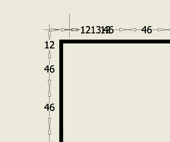

Hello, I have been working on making automatic dimensions in a .dwg document but I have not been able to center the text of the dimensions, since the occurrences can vary in size and add more, I do not know if you can help me to center the text so that it is always in the center regardless of the size of the occurrence.
Since if I try to give size to the text on some occasions it is put with another dimension or it is too small, I attach the code that I am working on.

m_baczewski
Give it a try as I mentioned, at this point it should go through all the dimensions and center their positions.

kv5053545
Hi @m_baczewski , I was trying the code you provided but, I keep getting the same thing that the dimensions are put to one side of the dimension in a way that I understand that is the size of the text but if I put it smaller to make a smaller assembly is not reached to read by the same thing that is very small, is there any way to make the text resize if it goes out so to speak of the range of the arrows?
m_baczewski
You can move the dimension text to the left side, for example of the code looks like this:

Try changing the size of the dimension arrows.You can also consider creating a drawing that will be more legible.
kv5053545
Hi @m_baczewski,
In the end, I didn't get the text to fit automatically, I decided to let the user choose the text size (based on another post here in the forum).
This rule only changes the text size, and the rule you provided I used to leave the values from the default style editor.

jaime75
o que eu  preciso é o contrario, preciso que quando o espaço para o texto for muito pequeno o texto seja automaticamente movido para a direita ou para a esquerda da linha
