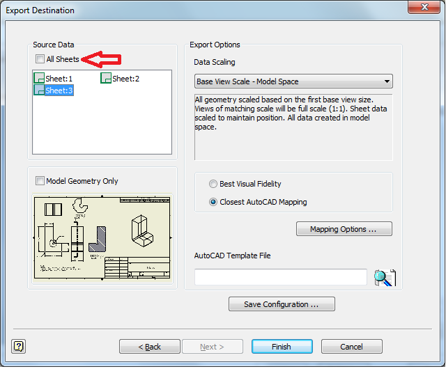

I want to save an idw drawing as a dwg but only sheet 3 of a 3 sheet set I found this snippet on the forum but cant get it to print only sheet three any help would be appriciated code is below.

With the VBA code, inventor supports to export the ACTIVE sheet only. Making the minor change to your code can meet your requirement.
1. Generate an ini file. Uncheck the All Sheets option in the dialog below. Click the Save Configuration ... button to save it as C:\temp\DWGout.ini (This file name is referenced in your code).
2. Prior to running your VBA code, active the sheet3. (It can be done by the VBA code)
3. Run your VBA code to export the active sheet.

Thanks Jeffrey
