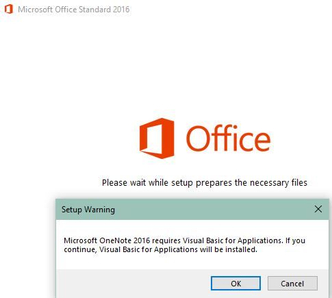

I've code to read a list of file paths from excel (to save as pdf's) but something has happened to excel (will hopefully fix soon) - but whilst the excel error appears on opening I 've realised it's opening & closing for every call.

Is it possible that only the standard application for file type xls and/or xlsx has changed from Excel to OneNote. What happens if you double click your excel file in windows explorer? Does it open in Excel?
