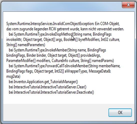

i wrote some Tools as AddIn in VB.Net.
With Inventor 2016 they work fine.
In Inventor 2017 i get an error message that a COM object is disconnected from the RCW and could not be used any longer.
This Error is initialized in the Closing section of the AddIn after closing InventorApp.

Any idea how i can recognize which COM Object creates the error message?
When i have a look at the debugger there is no COM Object openend at this time.

I read in this post that there is a new Tutorial Manager in Inventor 2017.3
In the error message the Tutorial Manager is also contained. Could there be context?

 Hi, after hard work i could figure out that this code cause the problem:
'Closing Inventor
        If AddinGlobal.InventorApp IsNot Nothing Then
            Marshal.FinalReleaseComObject(AddinGlobal.InventorApp)
        End If
So when i delete it, the error message does not come any longer.
It's only in Inventor 2017!.
I am not sure wether this is a safe way and could cause other problems.
Is the FinalRelease of InventorApplication necessary?
I am excited about your opinion.
