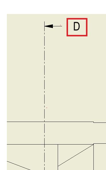

Hello All,
This is frustrating me to no end.
Is there any further API in iLogic that allows you to edit the Inventor View Annotations?
The only code I've found so far is DisplayDefinitionBase As Boolean
In Particular I am trying to search all view annotation text & then be able to add custom text to it via iLogic code.
Any help would be much appreciated
Kind Regards
Tim

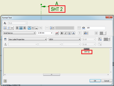

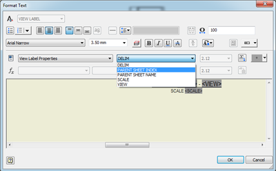

Thanks for your reply Brandon
Yeah at first I thought that was it but then quickly realized that interacts with the actual section/detail view label not the section/detail view annotation symbol/text.
To further clarify what I am trying to accomplish is basically a simplified version of the app "View Reference" created by CAD Apps Plus on the Autodesk App store (app doesn't support Inventor 2017 yet Smiley Sad)
So when I move a section or detail to another sheet in my idw I would like my section/detail view annotation text to reflect sheet number of child view.
Hope this clarifies it enough.
Thanks for your help in advance Smiley Happy
Tim

Message 5 of 9
Thanks Brandon,
I agree with one of your comments in those linked posts, I can't believe that section view annotations have little to no functionality.
I got this working to a degree which was great, but as I investigated further the section symbol works great for sections but does not work for detail views as these don't have a sketch to interrogate.  Smiley Sad
This might be one for Inventor devs to incorporate me thinks.
Tim
Message 6 of 9
asiteur
Hi Tim,
Seeing your screenshots with SHT 2, how about adding a new document property to your file (e.g. <EXTRA_DRAWING_TEXT>) and then pushing the proper value to this property? This would work is the amount of different annotations is limited, but you like to update them every once in a while.
Would be very simple to implement. Just trying to think along with you.
Alexander Siteur
