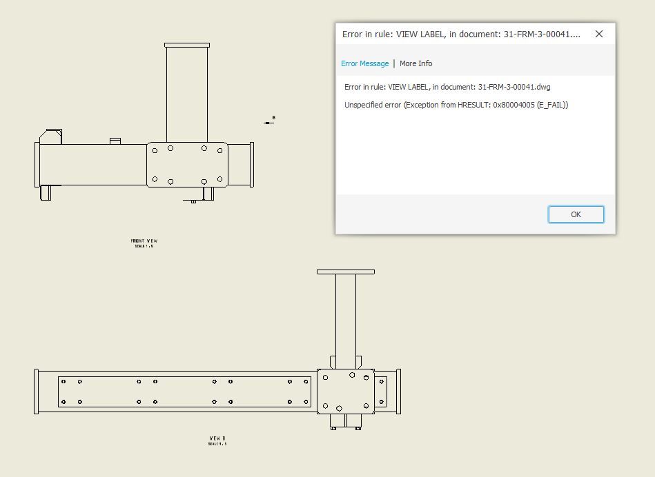

The problem I have is if I place a base view in a rotated orientation, it does not  update the View label. See below
Base view on Left in default orientation, Base view on Right Rotated 90deg on view placement.
Any help with editing this rule to allow for rotated views to populate the view label will be much appreciated. Thanks

Hi, thanks for writing that into the script. I tested it and it works for a view rotated after placement but does not work for a view that is placed in a rotated orientation. Is there a way to make it work for both types of rotated views?
Also I got an error in the rule when I had an Auxiliary View that had the alignment broken. Any idea why that would be? See below image.
Message 7 of 8
Ralf_Krieg
Hello
I found no solution to rotate back base views that are rotatet on placement. Maybe it's possible to rotate this drawing views stepwise 90° and check drawingviewtype after each step. This would only work if the user has not rotate a free angle or rotate free in orbit. I think we've nearly reached the limit of automation.
I think the error message appears as we try to rotate back a not rotated view. I've modified the code to rotate onle if drawingview rotation is not 0.
