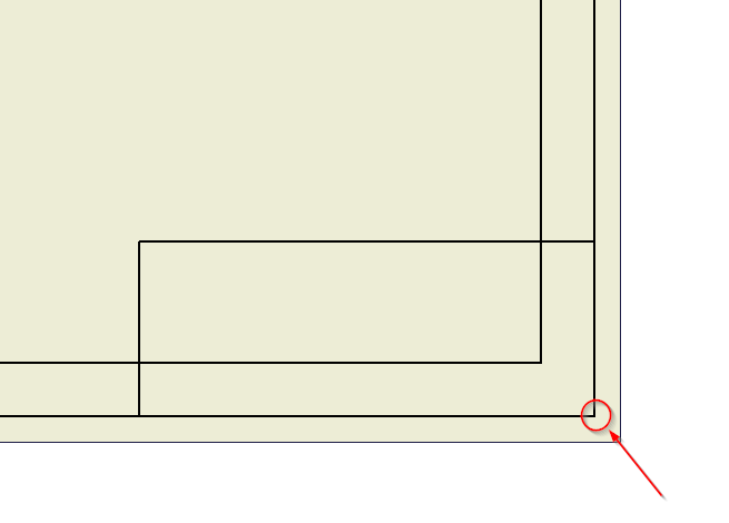

Can some body help me out with the positioning of title block in the drawing sheet having dual borders.
The default setting will insert the title block on the bottom most line of drawing border.
I am expecting it to be placed at the corner as shown below.

JelteDeJong
hi,
in the titleblock definition add an Point and turn it into a "Connection Point Grip". Set the dimensions the same as the width of your border.
Jelte de Jong
Blog: hjalte.nl - github.com
Thanks for you help. That worked!😐
