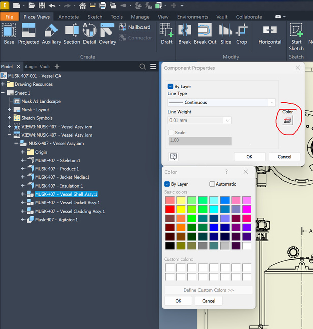

I am after a little help with some iLogic code and don't know where to start.
I want an iLogic rule that will change all Occurrences of a part or sub Assembly of a given name to be a certain colour. I want to change the component property for colour and not select the model edges and add them to a coloured layer because I want the other line properties to be unaffected.
For Example all Occurrences of "SubAssembly1" on the drawing will turn blue and Occurrences of "SubAssembly2" on the drawing will turn green
We use a standard set of colours so these can be hard coded and not detected from the model in any way.
Can Anyone help with this?
Thanks in advance.

Thanks for the response. The code I found at the link is not quite working. Example below.
There are 2 problems with this.
The first one is that it only looks in the top level of assembly. It doesn't nest through multiple layers of sub-assemblies. How can I achieve that?
The next item, I wanted to select the component occurrence property and change that rather than select all the edges and change the edge properties. Is that possible?

brotherkennyh
I also have some code for a similar problem from one of my own past posts. Sadly I have not become more familiar with iLogic in the mean time. Link to previous problem below.
The code here works through every component and searches multiple layers of sub assembly including patterns.
The problem is that it layers the components and colours the layer. Doing this enforces other properties like line type. I want to just change the colour, hence the desire to change the occurrence property in the browser.
Solved: update drawing line colour based on part colour - Autodesk Community - Inventor
brotherkennyh
I am just posting some code I got working.
This selects the component edges and changes the property of those. I would still prefer to change the component property if someone knows how to do this?
I am also open to any improvements.

brotherkennyh
Thanks for the response. I am looking to change the assembly occurrence as it appears on the drawing. Menu shown below for clarity.
The code I provided does find and colour the desired component by name in all views, but it does so by selecting the edges and changing the edge properties. I would prefer to change the occurrence properties, as below, if this is possible. In fact I don't know how to change any of these properties through iLogic.
