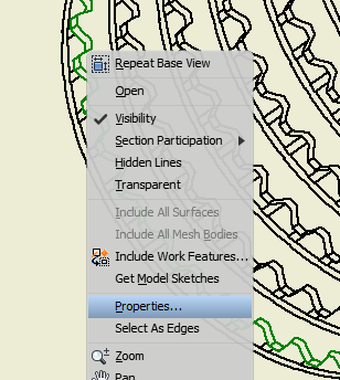

Wondering if anyone has found a way to access the properties pane of a particular part in a drawing view, like in the following pictures:
End goal is to be able to be able to automatically apply a color to every instance of a part inside of large assembly drawings. I can get it to work by getting a subset of the view curves using the DrawingCurves() property, but it's very slow, even when working with few parts/edges. By contrast, the properties menu for the component allows the color to be set and Inventor handles it very quickly, so I would love to tap into that instead. I could do it with a different layer for each color, but that's not what I want, and that's not how Inventor handles the color change via the dialog anyway.
Any thoughts?

Thanks for offering this solution, but it doesn't help much due to the layer change being executed all at once using the .ChangeLayer() method. The remainder of your code is essentially what I've already been doing with .DrawingCurves(), so my original problem still exists. Is there any way to apply color at the part level in the drawing view rather than by select edges?
Message 4 of 16
JamieVJohnson2
Other than select as edges...  I'm afraid in the background that is what is actually taking place.  But once you have the drawing curve segments of that component, you can repeat the feature like this:
 Dim drView As Inventor.DrawingView
Dim oColor As Inventor.Color = invApp.TransientObjects.CreateColor(100, 200, 150)
'apply color while looping through the segments and curves.
            drView.DrawingCurves(1).Item(1).Color=oColor

The syntax for iLogic and VBA are slightly different, though both are based on Visual Basic. The primary issue with using jvj's code in VBA is that you can't use dim to declare a variable and then assign a value to it in a single line. For example:
Dim strComponent As String = InputBox("Insert Component Name")
needs to be changed to this in VBA:
strComponent = InputBox("Insert Component Name")
In general, VBA is split into Forms, Modules, and Class Modules. For most stuff, you'll write the bulk of the code in a module and supplement it with a userform if a gui is needed. Much of the syntax is identical to iLogic, so you should be able to see how things work if you've worked with iLogic.
Here's a piece of what I've written to change the color of all parts contained in assemblies or presentations in the active document. It's pretty rough but it gets the job done. Paste it into a module and you should be good to go.
Sub ChangePartColor()
    Dim oDoc As DrawingDocument, partStr As String
    If ThisApplication.ActiveDocumentType <> kDrawingDocumentObject Then
        Call MsgBox("This macro only works on drawing documents.")
        Exit Sub
    End If
    Set oDoc = ThisApplication.ActiveDocument
    partStr = InputBox("Part to color:", "Prompt")
    Dim oTrans As Transaction, i, j, k, c
    Dim ViewCurves As DrawingCurvesEnumerator, refAssyDef As ComponentDefinition, oColor As color
    Set oColor = ThisApplication.TransientObjects.CreateColor(255, 0, 0) 'RGB
    Set oTrans = ThisApplication.TransactionManager.StartTransaction(ThisApplication.ActiveDocument, "Colorize [PART]")
        For Each i In oDoc.Sheets
        For Each j In i.DrawingViews
            If j.ReferencedDocumentDescriptor.ReferencedDocumentType = kPresentationDocumentObject Then
                Set refAssyDef = j.ReferencedDocumentDescriptor.ReferencedDocument.ReferencedDocuments(1).ComponentDefinition
            ElseIf j.ReferencedFile.DocumentType = kAssemblyDocumentObject Then
                Set refAssyDef = j.ReferencedFile.DocumentDescriptor.ReferencedDocument.ComponentDefinition
            End If
            For Each k In refAssyDef.Occurrences
                If k.name Like partStr & ":*" Then
                    Set ViewCurves = j.DrawingCurves(k)
                    For Each c In ViewCurves
                        c.color = oColor
                    Next
                End If
            Next
        Next
    Next
    oTrans.End
End Sub
