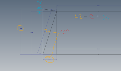

Does anyone know a trig function to solve for "X"?
chris
I'm trying to solve for "X", but I need to do it based on 3 knowns: (LOD, SOD and Radius)
I'd like to see how to write this in both Parameters as well as how to write it in iLogic
or
how to solve for "Y", as I have a formula to solve chord length, but that requires knowing the angle of "Y"

chris
I was able to figure it out with a couple sketches and some triangles, it now looks like this:

mat_hijs
You have 2 sides of a right triangle, you can use a²+b²=c² to get the third and then x would be R minus the third side.
