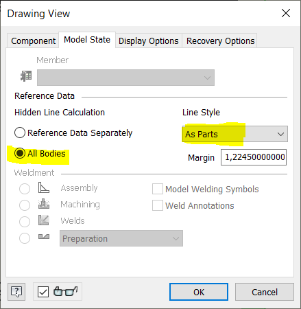

I have a View from an Assembly. The Assembly has referenced parts.
The referenced parts are showing through other components in drawing views.
I want create an iLogic-Rule to change the view from this:
to this:
To recive this I have to change the settings from this:
to this:
This is my iLogic Rule, but I can't finde the right option/parameter to change the setting from the image above.

That's a tough one.  I don't see any option in for a DrawingView that gives you access to those settings.
You can review the current help file for the DrawingView Object at the link below.
http://help.autodesk.com/view/INVNTOR/2020/ENU/?guid=GUID-D273D9C3-C24F-4CDD-B571-F2C0B5F7A5B3

Please log this wish list at idea station using below link.
https://forums.autodesk.com/t5/inventor-ideas/idb-p/v1232

I created it here...
https://forums.autodesk.com/t5/inventor-ideas/drawing-view-model-state-hidden-line-calc-amp-line-sty...
