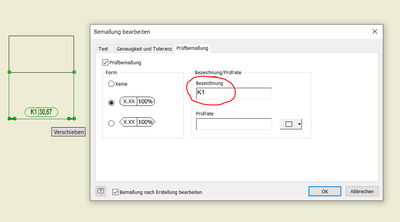

I need help with the Excel export of the dimensions. Everything works as it should, but I would also like to have all labels exported. Unfortunately I can't do this without errors. Can someone help me out here?

Hi @max.baumann07.  It looks like you are looking for the information in the following places:
DrawingDimension.IsInspectionDimension
DrawingDimension.GetInspectionDimensionData
DrawingDimension.SetInspectionDimensionData

max.baumann07
Thank you!
Got it.
If anyone needs the code:
