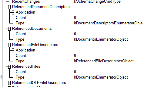

Not as straight forward as it seems.  I have a file that refuses to disappear from the referenced files collection.  It does not show up in either BOM.rows or component occurences.
the delete method is not available for document or documentdescriptor so how to i delete this file?

When I open your iam file in the Inventor 2015  the Resolve Link Dialog indicates the missing file
asep\A1008639_Chainwheel_In_Work_01011581.ipt
After I skip this unresolved file reference I see the referenced files collection that is empty.

I had to doubt myself and wondered why i didnt try that already, then i remembered i did.  The reason i started looking for a vba solution is because the 'Links' button is greyed out.

Vladimir.Ananyev
No, unfortunately API does not provide any tools for this Smiley Sad

It is possible to open the document ignoring Resolve Links dialog.
Application.SilentOperation property helps to proceed the open file operation without prompting (if that gets required...e.g.: error message dismissal).
ThisApplication.SilentOperation = True
Set oDoc = ThisApplication.Documents.Open(filename, True)
ThisApplication.SilentOperation = False
In more complicated scenario you may consider FileAccessEvents.FireOnFileResolution method that could give you the unresolved filename.

Vladimir, you're confusing me.  Go back to my OP.  I dont want to suppress the message, i need the link to the file removed without changing the file version from 2012

Unfortunately I have no good news for you, sorry for that.  There isn’t a way to directly delete the references in an assembly.  They are created and removed as you do things that require a file reference.  But you may try to automate the workaround that works for you in UI.
