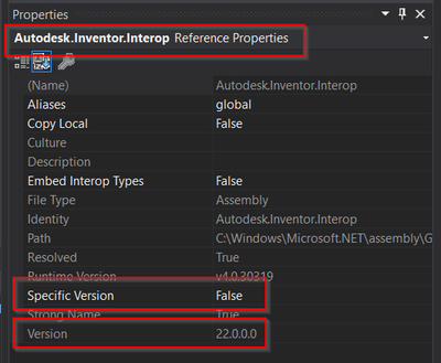

dllRefrenceProperties.pngYou could check dll refrence properties of "Autodesk.Inventor.Interop.dll".
My values for Specific Version and Version match yours, although Copy Local is set to True. Could that cause any specific issues?
