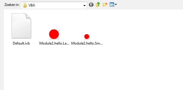

mr_ensing
Edit: it seems i reacted on an old thread. Oh well.
Check the resolution of the images. 16x16 pixels for small. 32x32 pixels for large.
Other than that, i don't see much wrong with it. I ran a quick test:
