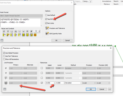

Ya Good,
Could you please help me to create the iLogic function.
Actually i have taken the hole callout then i removed the {±TOL} [?] these and Right click>Edit hole note>Precision and tolerance>add tolerance manually which is mentioned below.
Example:
ThreadsizeSeriesMinMax
2.000-8UN-0.0050.015
2.000-12UN-0.0060.016
1.875-6UN-0.0040.014
1.500-8UN-0.0030.015
My requirement:
After taken the hole note, click the hole note and use iLogic form >select threadsize (2.000-8UN), the data mentioned tolerance has automatically applies to the hole diameter.
Hope you understand.

Above you told points are currently we doing this practice but need to add the <TDDIA> tolerance by automate by using iLogic forms. please see the attachment, the marked area.  why its appear {±TOL/}? If we know these, we can use this parameter automate.
Message 10 of 14
RNDinov8r

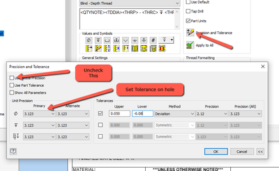

I think I figured it out. You want it to look like this?
In your new dim style, make sure you have Tap Drill box checked. Then when you expand to edit the tolerances, it will show up in the list.
Message 11 of 14
gparamasivam
Yes, But its a manual method and this our current practice too.
Every-time i refer from the master data sheet, check the tolerance for required Thread size and add the tolerance in Precision tolerance box .
We need to automate this,
Click the thread note>open iLogic>select the required thread size>Tolerance will add automatically.
If i click 2.000-8UN thread size - 1.875 -.004/+.015 Should add
