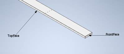

ilker_akay
Hello, we have many parts during the design phase and it takes a lot of time to prepare technical drawings. To speed up the process, I discovered ilogic and API in Inventor. There are many sample codes on the forum, I understand the logic a little. What I want to do now is;
1- I can do this with the code I shared as an example. There is a scale problem, I could not figure out the reason.
2. The starting plane or axis of each part may be different. To overcome this, I made 2 definitions in the piece. "Front face" and "Top face". I want to show the piece accordingly in the view. How can I do this with ilogic or c# api?

i added sample part1.ipt and video.ilogic code is in the model and uses the standard template for idw file.
I think I solved the scaling problem. I confused oview.width and oview.height.
My main problem is that part drawings do not start from a standard plane. (YZ, XZ, ZY can be one of the planes). When this is the case, it becomes impossible to create a standard main view. The solution is to assign names to the faces in the model. As you can see in the example, I am assigning names to two surfaces. I want to create the main view based on "My Front Face" and "Top Face" and these faces. "My Front Face" will always be the front face in the main view, "Top Face" will always be facing up in the main view. In short, I want to create the main view in the technical drawing according to these faces. I hope I could explain.

Let me explain it this way with pictures.
1).The first face assigned("MyFrontFace") or selected will be the front face in the drawing. No problem so far. A drawing appears based on the selected face.
1 - Result
2).  2. The selected or assigned("MyTopFace") needs to rotate up, 180 degrees according to its appearance in the drawing. and this is the result I want to achieve.
I think it will be better understood this way😔

The purpose of the 1st face I assign("MyFrontFace") is to always turn that face into the front face in the drawing view.
The purpose of the 2nd face I assigned ("MyTopFace") is to use the assigned face so that it is always on the top side like in the picture.
I can't rotate it up because I don't know how to find the direction of "MyTopFace".
Message 19 of 21
AndrewHumiston
Let me work more on this Monday I can figure this out
Message 20 of 21
ilker_akay
Finally I somehow succeeded.
I'm adding the code and ipt file here. Maybe it could be useful to someone.
