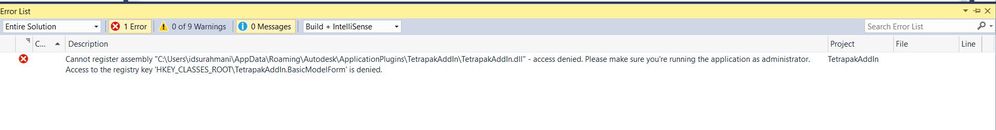

I am trying to move form iLogic/VBA to Add-ins/DLLs.
I am using Inventor 2017 and VB 2008 Express.
Where do I start? I have had a look at sample files given when installing Inventor as well as tutorials such as this but I seem to constantly get errors, perhaps because the tutorials are outdated, I don't know. I am looking for a typical "Hello World" dll sample to get the wheel rolling. Any suggestions please?

Error 2 Type 'CommandTypesEnum' is not defined. C:\Users\Public\Documents\Autodesk\Inventor 2017\SDK\DeveloperTools\Samples\VB.NET\AddIns\SimpleAddIn\AddSlotOptionButton.vb 12 42 SimpleAddIn
Error    3    Type 'ButtonDisplayEnum' is not defined.    C:\Users\Public\Documents\Autodesk\Inventor 2017\SDK\DeveloperTools\Samples\VB.NET\AddIns\SimpleAddIn\AddSlotOptionButton.vb    18    57    SimpleAddIn

Strange, I have same sample, and working fine with no error. I'm using Inventor 2018 with VS 2015
Please use the ACCEPT AS SOLUTION or KUDOS button if my Idea helped you to solve the problem.
Autodesk Inventor Professional Certified 2014
Message 10 of 14
Jacques.Grobler
The sample works in Inventor, but I get the errors in VS as indicated. Could it be because you use a later version of VS?

Message 14 of 14
Frederick_Law
Check if VS is referencing Inventor library.
I don't have Inventor on this computer, so its missing.
Also it could be VS2008 doesn't support .Net 4.  Did you install .Net 4 SDK?
