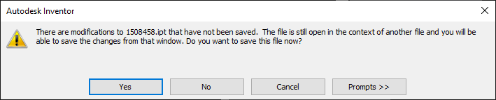

But I get this warning for each part:
If I click "Yes", I get the following errors:
I assume this is related to some infinite loop situation because my code executes on save. If I click "No", it works fine with no errors, but that means I have to remember to click the correct button each time and I have to actually click something every time a flat pattern is created. I'd rather have no user interaction. Does anyone have any suggestion on how to fix this?
