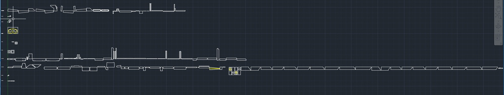

hey @DavidWHouse,
here are some examples of what we do for cut lists, we take flat patterns from inventor and put those into one single autocad drawing. Our program sorts all the materials and the thicknesses of the sheet metals.
Some worthwhile ideas

tolgay.hickiran
Yes david,
the we've written a 3rd party program for this and it is proprietary so i cannot share it with the public. I just wanted to show you an example of what you could do with flat patterns
