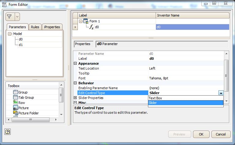

The Add Form command is hidden in the drop down under the iLogic panel on the Manage tab:
That command will put you in the Form Editor.  Dragging a parameter from the left to the right will add it to the form.  To attach a slider to it, click o nthe parameter on the right and look at the Properties.  Change the property named Edit Control Type.
