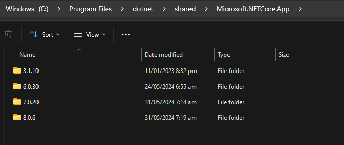

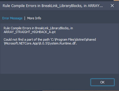

I have been getting this error message occasionally since upgrading to Inventor 2025.
Maybe once a week or so. A restart of Inventor fixes it, but I would like to know how to make it go away for good.
It is missing "C:\Program Files\dotnet\shared\Microsoft.NETCore.App\8.0.5\System.Runtime.dll"
The folder 8.0.5 does not exist on my computer but I have 8.0.6, which is listed as the active version of .NET.
Any pointers on how to resolve?

Michael.Navara
This looks like a issue in used references. Without the source code it is not possible to identify the issue.
But you can look if you don't reference System.Runtime.dll directly in your rule or external library.
william
The iLogic rule with the source code, has all lines commented out. It is no longer used. There is no direct reference in the code.
I am wondering if there is an internal inventor reference to this dll somewhere.
How would I check, and is it something I can access?
Michael.Navara
william
Thanks @Michael.Navara
Installed successfully, hopefully that clears it for good.
