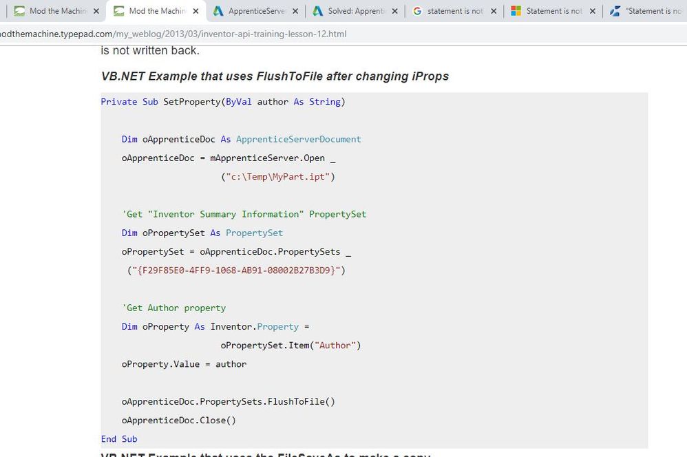

Still figuring this out - copied code & pasted it into a new form (Visual Studio 2019 .Net 4.5 Inventor 2018)
& 5 errors appear - fixing errors isn't easy. Any  hints/tips appreciated
ref:
https://modthemachine.typepad.com/my_weblog/2013/03/inventor-api-training-lesson-12.html
Regards
Andrew

For example, you should modify the following code
oApprenticeDoc = mApprenticeServer.Open
               ("c:\temp\block.ipt")
to
oApprenticeDoc = mApprenticeServer.Open _
Or, simply write like this :
oApprenticeDoc = mApprenticeServer.Open("c:\temp\block.ipt")

Thanks, down to 1 error now...
HideoYamada
Change the following line.
'Dim mApprenticeServer As ApprenticeServerDocument
Dim mApprenticeServer As New ApprenticeServerComponent
