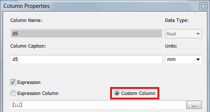

Make a Save Copy as of the family creating the family with hole and the one without hole.
Edit the family table of both families.
Remove the key column you don’t want to see in the insert dialog of the specific family.
Redefine the column property according to your need.
Suppress the rows you don’t want to use for that family.

Hi Aurélien,
Sorry for being unclear, but, I was suggesting just a general procedure.
If you see the column when you insert the component and it is not a key, it is because it’s a custom column.
Even in this case, you cannot set the column for behaving as custom just for some members and not for others.
