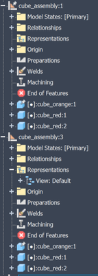

Is there a way to get the 'Representations' to load on an occurrence that is loaded using the API?
I insert the occurrence like this:
componentOccurrence = assemblyDocument.ComponentDefinition.Occurrences.AddWithOptions(
    inventorFilePath,
    matrix,
    options);
if (string.IsNullOrWhiteSpace(viewRepresentationName) is false)
    componentOccurrence.SetDesignViewRepresentation(viewRepresentationName);
In the image below, the top assembly was inserted with the API & the second assembly was inserted manually via the Inventor user interface. As you can see, the 'Representations' are not loaded for the first assembly even though they are the same file.

@TylerWarner33 , hope you're doing well!
I think the trick here is to set the veiw rep to be associative with the options.
inventorFilePath = "C:\Temp\Test01.iam"
Dim oAssemblyDocument As AssemblyDocument = ThisDoc.Document
Dim oPositionMatrix As Inventor.Matrix = ThisApplication.TransientGeometry.CreateMatrix()
Dim oOptions As Inventor.NameValueMap = ThisApplication.TransientObjects.CreateNameValueMap()
oOptions.Add("DesignViewRepresentation", "Test")
oOptions.Add("DesignViewAssociative", True)
Dim oComponentOccurrences As ComponentOccurrences = oAssemblyDocument.ComponentDefinition.Occurrences
Dim oOcc As ComponentOccurrence = oComponentOccurrences.AddWithOptions(inventorFilePath, oPositionMatrix, oOptions)
Or set that after it is placed:
oOcc.SetDesignViewRepresentation("Test",,"True")

Thanks @Curtis_W , hope you're doing well too!
That seemed to do it. I was testing with that previously but kept getting errors. Turns out, the 'associative' will throw an error if trying to associate to the "[Primary]" view representation.
