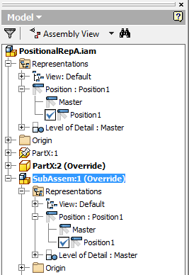

I have the same problem, but for me its not possible to tie the pos reps together. I'm configuring a band with different supports. Each support is configured with a range; 600-900, 900-1200, 1200-1500 etc. those ranges can be adjust by 50mm and those steps are specified by the pos reps (see attached image).
All the different supports are put in the top assembly and in this assembly I want to switch between the positional representations. I tried to use:
ThisApplication.ActiveDocument.ComponentDefinition.RepresentationsManager.PositionalRepresentations("MyPosRep").Activate
But it won't work. I guess I have to replace "ComponentDefinition" in one way or another to the component name, but I don't know how.
I hope you understand my problem and you are able to help me!

The best I've come up with is to have a subassembly that has Rep-pos and then insert it into an assembly and create rep-pos in that assembly with the same name as the subassembly and then use the following code:
SyntaxEditor Code Snippet
' set a reference to the assembly component definintion.
' This assumes an assembly document is open.
Dim oAsmCompDef As AssemblyComponentDefinition
oAsmCompDef = ThisApplication.ActiveDocument.ComponentDefinition

It does change the rep-pos of the top level and the sub assembly. But you can only save in the Master rep-pos so this method does not work.
Message 10 of 10
this is the same problem I had. But its fixed now! Thanks!
NOTE: make sure your "top assembly" and "sub assembly" positional representation has the SAME spelling & capitalization; otherwise it wont work.
 NOTE: if you follow ben_neb43 steps, you will see your subassembly has (override) on it
