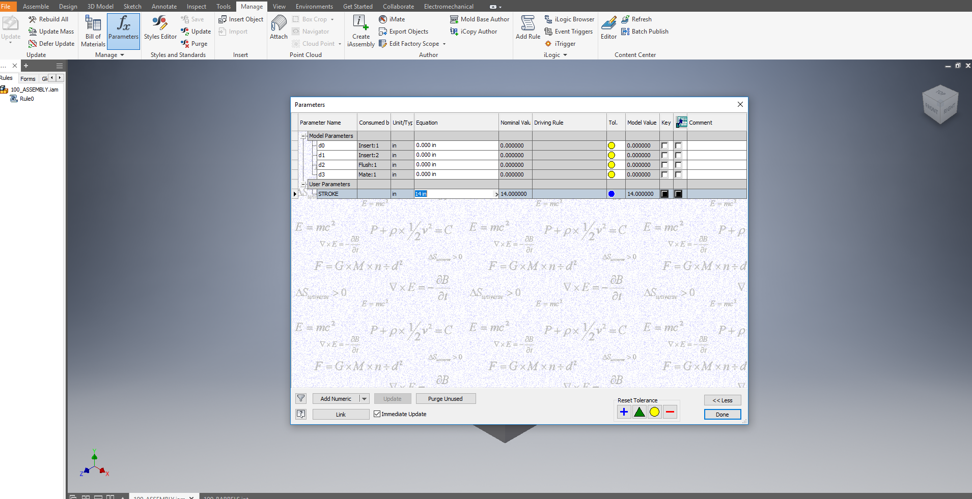

Getting the same error trying to change the parameter this way! However, I can change it from the parameters dialog box in the part file. Do I have to somehow change it from the part file first to update the assembly? Is there a way to do that without having to open up the part file every time?
