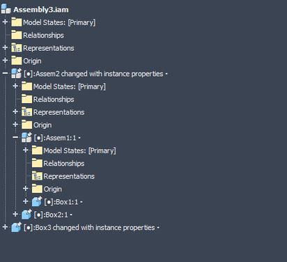

Hi!
I know it has been a few years since this was resolved but I am trying to reuse the code and it works fine in the main assembly but it does not change the name of the components/Occurences in the sub assemblies.
I've tried to debug it a bit and it seems that it still iterates over every item but it does not update it.
Has something changed with iLogic/Inventor over the years where it blocks the updates in sub assemblies or maybe I am just bad 😄
See before and after picture from a dummy assembly
Message 6 of 11
WCrihfield
Hi @martin.djignagard.  Were all of the instance properties assigned to all of the occurrences while the 'main/top' assembly was the 'active' document, or were some of them assigned to sub components while other sub assemblies were the active document.  Knowing this detail is important, because 'instance' properties depend on whichever Document was currently the 'active' (visibly showing on your screen at the time, for editing), and I believe they may also depend on which ModelState was 'active' at the moment the instance property was created.
Also, there are two different ways to recursively iterate over multiple levels of component occurrences in an assembly, and each way can change how things work.  When using the ComponentOccurrence.SubOccurrences property to access lower level occurrences, the lineage or association with the top/main assembly is preserved, meaning some types of changes made will be made from the perspective of the top/main assembly, instead of the individual occurrence definitions being iterated through.  However, when using ComponentOccurrence.Definition.Occurrences to iterate through them, it is actually stepping down into the 'definition' of the sub assembly, instead of just another layer of sub components of the top/main assembly, and because of this, most/all changes made will effect the individual component definitions (and files where those definitions are saved) for all those occurrences.  Which way is best for a specific situation depends on your goals, what you are planning on doing to/with each occurrence, and where you want the changes to be saved.
So, if all instance properties were assigned to all sub occurrences while the main/top assembly was active, and the same ModelState of that main/top assembly was also active during all instance property assignments, then the original way of iterating the sub occurrences (using SubOccurrrences property) would be best, but if instance properties were assigned while other sub assemblies were active, then they will only be found again when that sub assembly's definition is being worked within again, so stepping down through the occurrences by way of their definitions would be necessary.  And if my theory is correct about the same ModelState that was active when the instance assignments were made needing to be active again to find those instance properties, then there may need to be some ModelState activations included in the process also, but I am not sure.

martin.djignagard
Hi @WCrihfield and thank you for a very thorough and quick response, much appreciated!
I tried switching what was used in the recursion call from SubOccureences to Definition.Occurrences and it worked great!
To be honest I am no sure what is meant that the 'main/top' assembly is active when creating the instance property. From my knowledge you can only assign IP to children of the current assembly/sub assembly that is active, see snippet where inventor does not allow me to edit the IP of Box2, only when I am in Assem2/Assem2 is active I am allowed to edit.

It is true that there does not appear to be a way to 'manually' create or work with instance properties of lower level sub occurrences, but I was not sure if you may have created them using a code based process, such as something similar to the one you are attempting to use here.  I probably could have worded it better.

Stakin
I modified @WCrihfield 's Snippet, by now ,it can change sub assembly occurrences name, try
