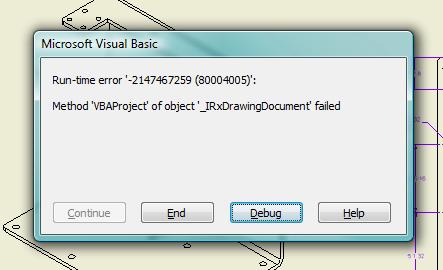

Hey y'all - little problem with some long running code. Since moving to Vista Business (64) half of my users have had trouble with the following code. Firstly the code hangs (see attached image) when trying to access the target documents VBProject. (The initial VB error will be contained in the next post). Secondly, the code seems to be cycling the NumLock setting when it fails. 3 of my Vista users are experiencing this while 3 others are not. Complete code set below. Any advice on what is causing this? Any suggestions in cleaning up my code also greatly appreciated!
Note - In XP I had to cycle the VB editor open and closed, I don't know why, to get the code to work. I have a sneaking suspicion that this action is definately related to the problems.

Message 2 of 9
Additional Information - If the user manually starts and then closed the VB editor the program runs OK, still cycles NumLock.
Initial error attached.
thanks !!!!

Message 4 of 9
I'm not sure, but it seems like the problem is that the document's VBA
project is not getting created on some machines. And hence the
Document.VBAProject property fails. Activating the VBA environment may
trigger the creation of this project.
Any reason why you are putting the code into a document project, rather than
the application VBA project? Putting it into the document project would save
the code with the document when it is saved and may create maintenance
issues later. In general, adding VBA code to document projects is being
discouraged.
Sanjay-
