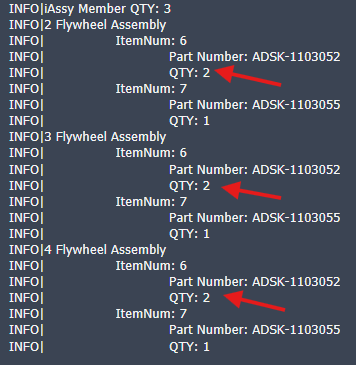

I can't get true values of ItemQuantity for (variable) components of iAssembly Members
My iLogic code is:
Option Explicit On
Dim aDoc As AssemblyDocument = ThisDoc.Document
Dim aDef As AssemblyComponentDefinition = aDoc.ComponentDefinition
Dim aBom As BOM = aDef.BOM
If aBom.StructuredViewEnabled = False Then aBom.StructuredViewEnabled = True
aBom.StructuredViewFirstLevelOnly = True
Dim fTbl As iAssemblyFactory = aDef.iAssemblyFactory
Logger.Info("iAssy Member QTY: " & fTbl.TableRows.Count)
'' ReCreate all Members
For Each row In fTbl.TableRows
	fTbl.CreateMember(row)
Next
	Logger.Info(row.MemberName)
	fTbl.DefaultRow = row
	aDoc.Update
	ThisApplication.ActiveView.Update
	' fTbl.CreateMember
	aBom = Nothing
	aBom = aDef.BOM
	Dim stBOMView As BOMView = Nothing
	stBOMView = (From bv In aBom.BOMViews Where bv.ViewType = BOMViewTypeEnum.kStructuredBOMViewType).ToList.FirstOrDefault
	For Each bRow In stBOMView.BOMRows
		Logger.Info(vbTab & vbTab & "ItemNum: " & bRow.ItemNumber)
		Dim compDoc As Document = bRow.ComponentDefinitions(1).Document
		Logger.Info(vbTab & vbTab & vbTab & "Part Number: " & compDoc.PropertySets("Design Tracking Properties")("Part Number").Value)
		Logger.Info(vbTab & vbTab & vbTab & "QTY: " & bRow.ItemQuantity)
	Next
	Threading.Thread.Sleep(999)
Next
When run on attached assembly it reports incorrect QTY for ItemNum: 6 (Part Number: ADSK-1103052)
Correct/Expected values are 2, 3 and 4 but I get either same values or only one correct and zeroes for rest two.
What I'm missing?

i'm not really familiar with iAssembly in general so below is something i come up with as a workaround.
since the first for-loop recreates the members and can be located in iAssemblyFactory.MemberCacheDir Property. and using the iAssemblyTableRow.DocumentName as the resulting filename, i just used them as references for the BOM of the members.

Maxim-CADman77
I currently got to the same workaround, but would like to use some more direct way..

Hi @Maxim-CADman77 - in an iAssembly you have to set the member in the BOM. It's not automatically set by activating a row in the iAssembly table. You can set it with BOMView.iAssemblyMemberName.
After you create the stBOMView object, add this line:
stBOMView.iAssemblyMemberName = row.MemberName
I tested that in Inventor 2025. It should work in earlier versions as well.
