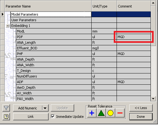

I would like to be able to use iLogic to get the value of the Comment field of a model's parameters.  I have some text there that I would like to display in a sketched symbol.  Is this possible, and if so, how do I do it?  The attached image illustrates what I am seeking.

Curtis_Waguespack
Hi cwhetten,
You can use this bit of code:
myComment = Parameter.Param("PDF").Comment
MessageBox.Show(myComment, "iLogic")
I hope this helps.
Curtis
cwhetten
Thanks, Curtis!  All I was missing was the .Comment member of the Parameter, so you gave me just what I needed.  Since I needed to pull this parameter into a drawing, this is what I ended up doing:
Modeldoc = ThisDrawing.ModelDocument
oModelParams = Modeldoc.ComponentDefinition.Parameters
iProperties.Value("Custom", "zUnits_ADF") = oModelParams.Item("ADF").Comment
iProperties.Value("Custom", "zUnits_PDF") = oModelParams.Item("PDF").Comment
iProperties.Value("Custom", "zUnits_PHF") = oModelParams.Item("PHF").Comment
Works like a charm.
