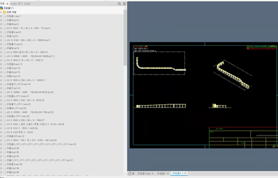

and below is first sheet picture
it is first sheet and it looks first sheet is not activated but I think error cuz I'm doing remote desktop in office from my home
did I something wrong again it's hard to understand proper Titleblock please help me

Hi @ssiem.  Thank you for posting the other error dialog image, and the translated contents of it.  I was also actually able to read some of the text in that view of the error message image also this time.  We can clearly see on the third line of text within the error message that it is encountering the error at the specific point where the PartsList.Add method is being called.  Since there are only two input parameters for that method, and it is saying that there is an invalid argument, and you have covered all the other possible causes of the problem, I now have another theory, but not necessarily a solution.  There may simply be something about that first view on that page that it does not like, for some reason.  We know that this method will fail if the sheet that you are trying to add the PartsList to is not the active sheet, but we are activating each sheet as we loop through them, so that does not seem like it could be the problem.  I am not sure if the type of DrawingView makes any difference, since that is not mentioned in the help documentation, but I wander if the view you specify must be a base view, or otherwise independent, rather than a projected, auxiliary, or section view, which tend to have 'parent' views.  I don't think this error has anything to do with the Point2d object we are providing to that method, so it must be related to the view.  I am about out of ideas.  I am not that familiar with interacting with a DWG type Inventor drawings, since all of ours have always been the IDW file type.  I doubt the file type of the drawing makes any difference though.
