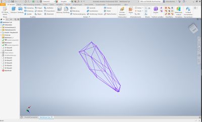

Hello @YuhanZhang may I ask you for help with this?
I want to create boundary patches where these triangles are, to make a B-rep solid out of this 3D sketch via VBA. I don't know what path to give to the boundary patch definition model, for it to create the patches.
I tried this, which didn't work:
Dim oLine3d As SketchLine3D
Dim oPath As Path
For Each oLine3d In oSketch3d.SketchLines3D
oPath = oDef.Features.CreatePath(oLine3d)
Call oBoundaryPatchDef.BoundaryPatchLoops.Add(oPath)
Next
