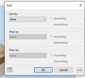

A.Acheson
Hi The sort is removing all manual sort criteria in Inventor 2020.
Before Rule Running:
After Rule Running:

GeertvanderHeide
the problem is when you have the bom open.
 when you click part number an arrow appears.
when this arrow is shown in any collumn the code doesn's work.
this arrow can be removed by right clicking the collumn tab and select clear sort.
but as far as i know there is no option to do this in code.
A.Acheson
I see the missing functionality now. I have likely had this happen to me before and was unaware of the issue. I checked the API and the commands list and there seems to be no way to clear this Sort Ascending/Descending filter. What does work is to import a clean xml. Which may not be ideal if you have made changes.
oBOM.ImportBOMCustomization("C:\Users\ImportBOMColumnSettings.xml")
Issue: No way to clear a manual Sort Ascending/Descending activated in the editor.
Regards
Alan
GeertvanderHeide
Ow that's a workaround does the job perfectly!
now i just exported the bom without any customization to an xml, and override that with the bom.
Only thing is that you override the bom everytime you run the rule. i don't know how much impact it has on performance, but what i can see now it works very smooth.
Thanks!
