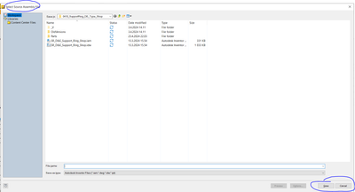

karram
Thanks for the guidelines,
I run this code into Assembly environment, then select source assembly file browser open, but its looks save mode. like below image.
If i select the existing assembly and hits save button, no action takes place.
Then if i give new name, then its give error as below images

WCrihfield
I will have to look into it further tomorrow...on my way out now.
In Line 2, change 'True' to 'False' to have it use the 'Open' dialog, instead of 'Save'.
That dialog will not actually open or save anything, just returns the String, but only if you actually select an existing file, not just type something into the textbox.
If it still is not doing anything, then I will have to look at it more tomorrow.
