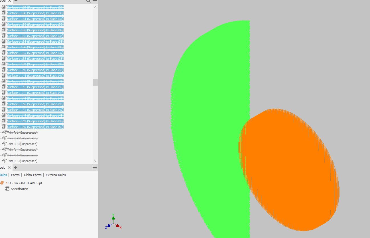

I have a problem I've been trying to solve for ages now.  In our company we build products called Vane Packs.  The packs are a collection of "Vane Blades" cut to length (straight end cut) to fit in a specific inner diameter.
Every blade is the same geometry, the only thing that changes is the length and distance (offset) from center line.  I have tried to automate this many times using master sketches with each profile for each blade and then extruding each as a surface, but the bigger it gets the slower it updates and the more snippet code I need to write to suppress a surface if it falls outside of the Inner Diameter.
Is there a way that I can just have 1 master Blade part, that can be added into an assembly with the length and offset being the only things that really change?
Any help/input would be awesome, as I'm at my wits end trying to figure this out.
Attached is an image of the product in question.

SRayne44
I currently have a Master sketch file, with a Shell Diameter, a sketch of the blade profile which is patterned off center by the spacing required.  This pattern exceeds (on purpose) the Shell diameter up to a number of blades I consider a maximum (150 left, 150 right), inside that Master sketch in Ilogic I have a rule that calculates each blades length as it gets closer to the edge of the Shell Diameter, and any blades that fall outside that are left with a uncalculated dimension.
From there I derived an .ipt file from the Master and painfully extruded a surface for each of the blade lengths (150 left, 150 right), and then had to write a rule that if any blades fell outside the shell diameter that the surface extrusion was suppressed.  This process however takes probably 15-25 mins to update anytime the shell diameter is changed.  Which just doesn't help workflow at all and I could draw it in 2D cad in 1/4 of that time.
Attached is a sample of the master file and a sample image of the derived .ipt file.
