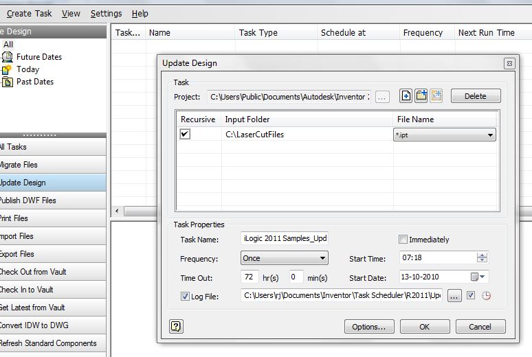

Rene-J
Hi Stefan
Try this Addin  iFlatpatternExport
http://www.mcadforums.com/forums/viewtopic.php?f=34&t=11249
In The addin
Set  Auto export on save sheetmetal part
set  on save create flattpattern if not exist
Use the Inventor task scheulder
create a task update design, select  directory,  select *.ipt in filename
and run the task.
René J

Message 8 of 11
I wrote a sucessful add-in that included the generation of a flat pattern if one didn't exist.  But that was back a while, maybe R9 or R10.
Currently I don't recommend trying to automatically create a flat pattern due to the rather illogical way IV now creates a flat pattern if you don't select the base face (something seems to have changed).  It may be my code, but if I automatically create a flat pattern it is invariably the wrong hand!
