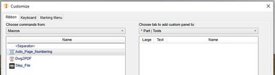

I created a macro button to run the code to make the process easier,
1) go to Tools/VBA Editor
2) in the tree expand ApplicationProject(Default.ivb) and right click on the Modules folder then select insert/Module
3) Copy and paste the below code (This code is assuming the above iLogic code is in your external rules)
Public Sub Auto_Page_Numbering()
Dim addIn As ApplicationAddIn
Dim addIns As ApplicationAddIns
Set addIns = ThisApplication.ApplicationAddIns
    For Each addIn In addIns
        If InStr(addIn.DisplayName, "iLogic") > 0 Then
                        addIn.Activate
            Dim iLogicAuto As Object
            Set iLogicAuto = addIn.Automation
            Exit For
        End If
    Next
Debug.Print addIn.DisplayName
Dim RuleName1 As String
EXTERNALrule = "Page Numbering" 'Name of your external iLogic code you want this macro to run
'Dim RuleName2 As String
'INTERNALrule = "Rule0"
  Dim oDoc As Document
  Set oDoc = ThisApplication.ActiveDocument
  If oDoc Is Nothing Then
    MsgBox "Missing Inventor Document"
    Exit Sub
  End If
'iLogicAuto.RunRule oDoc, INTERNALrule 'for internal rule
iLogicAuto.RunExternalRule oDoc, EXTERNALrule 'for external rule
End Sub
4) Rename the EXTERALrule = "Page Numbering" with your iLogic code name you want to run
5) make note of your module name (Mine is Module 3), save & Close VBA application window
6) I've attached the image I used for my macro buttons you may use them as well! place them at
     C:\Users\Public\Documents\Autodesk\Inventor 2019\Macros
     Rename the Images where they say "Module3" to what your module is named
7) In an Inventor drawing template right click on the ribbon/Customize User Commands...
8) where it says All Commands, Click on it and select Macros, your new button should be there.Macro Button.JPG   add and hit okay
your new button should now appear on the ribbon.
