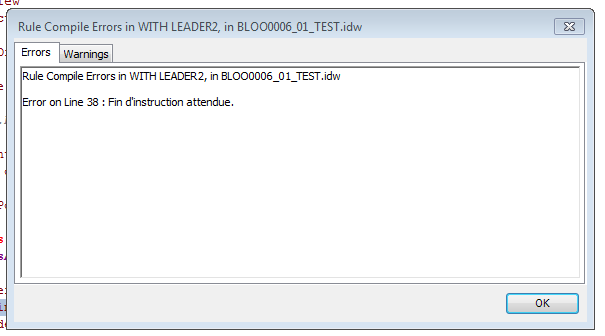

i trying with and without extension file but the same error?
Message 11 of 15
and when i delete de line with the occurence.name i have this error message?
Message 12 of 15
As I already said, I'm not sure if this works in iLogic. So try it in a VBA macro to see if it works.
If you're unfamiliar with VBA, check the programming help in Inventor.
Daniël
